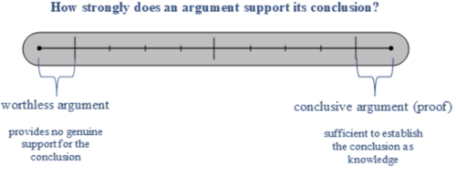

Scale of epistemic status
Notice that in the scale for epistemic status, knowledge is represented by a range and not by a point. This is because, even among the things we know, we think of ourselves as knowing somethings better than others. For example, you probably think you know both that Trump is the 45th President of the United States and that twice two equals 4. But you might think that you know the second of these propositions better than the first, since you can probably imagine some bizarre scenario in which Trump isn’t really the president and you’re the victim of an elaborate hoax, but it’s hard to imagine any scenario in which you can be mistaken that twice two is four. Perhaps some of you think that you don’t really know that Trump is the 45th President because you think you can’t totally rule out this hoax scenario. We’ll discuss these sorts of skeptical worries later in the course. For now, my point is just that to saying that you know something is not to rule out the possibility that there are other things that you know even better. That’s why I’m representing knowledge as a range rather than as a point. Similarly, to say that an argument is conclusive is just to say that it’s enough to establish its conclusion as knowledge. It is not to say that there cannot be some other argument that is even stronger.
The two factors that contribute to the strength of an argument are its premises and its inferences. So, to assess an argument we need to assess each premise and each inference.

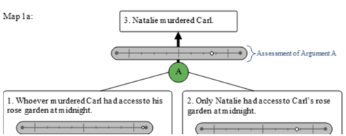

Map 1a
The scales placed in the boxed for Propositions 1 and 2 indicate the epistemic status of those propositions. The scale in the box for Proposition 1 has a mark in the rightmost region indicating that that proposition is known to be true. Proposition 2’s scale shows that the proposition isn’t quite known, though there is some reason to believe it. The scale drawn above the green circle indicates the strength of Argument A as a whole. We see that it is no stronger than the weakest premise, which is Proposition 2.
Since the case of Natalie and Carl is fictitious, there’s no way for us to actually assess the premises. The epistemic statuses in the map above are made up (as is everything else in the example). In §3, below, we’ll discuss how to assess actual premises of actual arguments.
In addition to assessing premises, we need to assess inferences. In order for an argument to support its conclusion, the premises and conclusion need to be related in such a way that it is unlikely for the conclusion to be false if the premises are true. The more unlikely it is for the conclusion to be false if the premises are true, the stronger the inference. Sometimes the premises and conclusion are related in such a manner that one would be caught in a contradiction if one held that the premises were true, but the conclusion was false. These inferences are called deduction and are said to necessitate their conclusions. Deductions are as strong as it is possible for an inference to be, so if we have a scale assessing the strength of an inference, we should represent deduction not as a range, but as a point at the end of the scale. (We will discuss how deductions work in §4.1, below.)
Place of deduction on the epistemic scale
Inference A is a deduction. If whoever murdered Carl had access to his rose garden at midnight, and Natalie was the only person who had access then, then Natalie has to be the murderer. If we said she wasn’t we would be saying that the murderer was someone other than Natalie who according to Proposition 1 had access to Carl’s rose garden at midnight, but Proposition 2 tells us that only Natalie had access to the rose garden at midnight. So, to hold both premises and deny the conclusion would be to say that Natalie was and wasn’t the only person with access to the rose garden at midnight, and that’s a contradiction. If the premises are true, the conclusion has to be. The only way to consistently deny the conclusion is to deny one of the premises. So, Inference A is as strong as an inference can be.
We can add this assessment into our map of Argument A as follows.
The scale below the green circle represents our assessment of Inference A, and it is marked at the rightmost point to show that the inference is a deduction. The scale above the circle represents our assessment of Argument A as a whole. Notice that, even though the inference is a deduction, the argument taken as a whole isn’t conclusive, because we don’t know that Premise 2 is true. The strength of the argument as a whole depends on the strength of all its elements, whereas the strength of the inference is independent of the strength of the premises. That’s illustrated by the following map:

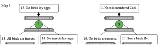

This map contains two separate arguments (Arguments F and G). Argument F has two awful premises—premises that no one has any reason to believe and that we all know to be false. But Inference F is as strong as can be; it’s a deduction. Propositions 13 and 14 are obviously false, but if they were true, then Proposition 15 would have to be true also. Nevertheless, Argument F is worthless, because its premises are so bad. Argument G is also worthless, but for an opposite reason. We know that both of its premises are true, but the premises aren’t related to one another and to the conclusion such that their being true gives us any reason to think that the conclusion is true as well. The problem here is with the inference. You can’t infer anything about Carl and Natalie from premises about birds and insects. Inferences this bad are called non-sequiturs.

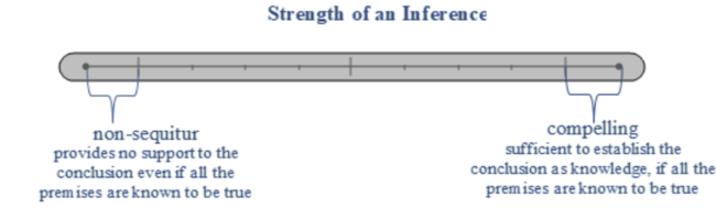

To assess an inference, assume that you knew all of its premises are true, and then ask yourself how strong a reason they would give you to believe that the conclusion is also true. How to assess different sort of inferences is discussed in §4, below, but you should be able to get an intuitive sense of how strong an inference is just by asking yourself if the premises were true how strong a reason would they give you to believe the conclusion.

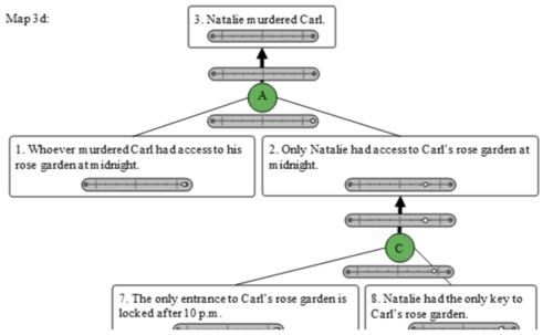

Let’s try this process, with Map 3 from above. Here the map is again:
Map 3:
export?token=0499e828-de4d-4abb-8c01-51fee1a3cacf&target=active&dpi=100&view=true&format=.png

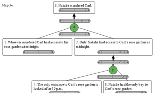

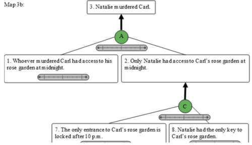

The first step is to identify all the inferences and unsupported premises. There are two inferences (A and C) and three unsupported premises (Propositions 1, 7, and 8). Proposition 3 isn’t a premise at all, and Proposition 2 is a premise for Argument A, but it isn’t unsupported, because it is the conclusion of Argument C. So, we will need to assess the premises and the inferences. In the map below I’ve added blank scales for the elements we will need to assess.

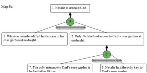

Let’s assess the premises first. If this were a real-life argument, we would have to reflect on how strong a reason we have for believing Propositions 1, 7 and 8, but since the example is fictitious, we’ll have to make up their epistemic statuses as well. I’ve done that in the map below:
As the premises are assessed on this map, we know Propositions 1 and 7, but we don’t quite know 8. Perhaps we think there’s some possibility that a second key was made or that Natalie’s key was stolen from her.
Now that the premises have been assessed we’ll turn to assessing the two inferences.
We’ve already seen that Inference A is a deduction, so it is as strong as can be. What about Inference C? It is definitely not a deduction, there is no contradiction involved in holding that someone other than Natalie had access to the garden at midnight, even though it is locked after 10pm, and Natalie had the only key. It’s just unlikely that someone else had access, since keys are the normal way of accessing locked places, and locks are designed to keep people without keys out. Still it’s possible for people to enter locked places without keys—locks can be picked, and presumably the rose garden has walls that can be climbed. To determine how strong Inference C is we’d need to think about how plausible these alternative routes of access are, and that would require some background knowledge. Assessing non-deductive inferences is more difficult than assessing deductions because it requires making use of such knowledge. In this case, since the example is fictitious, there is no background knowledge to rely on, so we’ll have to make up more about the example. If we took it for granted that the lock is of a kind that is almost impossible to pick without leaving marks (that weren’t found), that picking it would have taken time in which someone doing it would likely have been observed, and that the walls of the garden couldn’t be scaled without sounding an alarm (that didn’t sound), then I think this inference would be compelling. But in that case, it would be a lot clearer if the person making the argument had made these assumptions explicit by including them as premises. In any case, for the sake of the example, let’s assume that we aren’t in a position to quite rule out lock-picking and that the inference is strong but not compelling. That’s how I marked it on the map above.

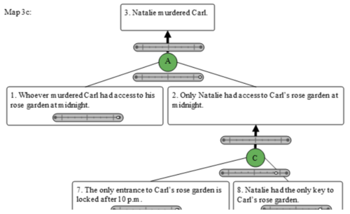

Once we have assessed all the unsupported premises and inferences, we can go on to assess the arguments as wholes. The map below incorporates all the assessments we’ve discussed so far, plus blank scales for assessing the two arguments.
If any of an argument’s premises are themselves supported by other arguments, we need to assess those other arguments as wholes before assessing the initial argument. So, in this case, we’ll need to assess Argument C before we assess Argument A.
Argument C has one premise (Proposition 7) that is known, but it has two weaknesses. Proposition 8 is not (quite) known to be true, and Inference C is not compelling. Either of these weaknesses taken on its own is sufficient to prevent the argument from being conclusive. The argument as a whole can be no stronger than its weakest element, which (as we’ve filled out the scales above) is Inference C. But since the weaknesses in an argument compound, and inference C is not the only weak point, in this argument, the argument as a whole is weaker than Inference C. We can represent this on the map below by putting a mark on the scale for Argument C a bit to the left of the mark on the scale for Inference C.
In addition to adding the assessment of Argument C to Map 3d, you’ll see that I added a scale for Proposition 2 and marked it with the same assessment. This is because this map shows Argument C as our reason for believing Proposition 2. The reason for having separate scales for Argument C and Proposition 2 is that sometimes we will have multiple arguments for the same proposition. We’ll discuss a case like this in a moment. Before we do, let’s finish assessing the arguments in this map.
What remains is to assess Argument A. Here there is only one weak element. One of its premises is known the be true and the inference is a deduction, so the argument as a whole will be as strong as the remaining element, Proposition 2. The dot indicating our evaluation of Argument A is therefore placed in the same spot on its scale as we placed the dot on Proposition 2’s scale.
If Argument A were the only reason given to accept Proposition 3, then we would give Proposition 3 the same epistemic status we’ve given Argument A. However, as we’ve already mentioned, conclusions are often supported by many, separate lines of reasoning. If that were the case, we would have to assess Proposition 3 in light of both the strength of Argument A and the strength of the additional arguments supporting it. This is shown on the map below (2a) which includes Argument A along with another argument (Argument B) for Proposition 3. (I’m omitting Argument C from this map to save space.)
Since Proposition 3 is supported (in this map) by two different arguments, to establish its epistemic status, we need to take both into account. Argument A is fairly strong, though not compelling.
But as I’ve represented it here, Argument B is very weak. Inference B is a deduction, but the epistemic statuses I’ve given to its premises are much weaker than those of the premises of Argument A. (Recall that since these are fictitious arguments about fictitious people, the epistemic statuses are also fictitious.) Proposition 6 is approximately as strong as Proposition 2, but Propositions 4 and 5 are considerably weaker, and in an argument the weaknesses compound, so the argument as a whole is considerably weaker than its weakest premise. It’s not quite worthless, but it’s not worth very much. At best it could give one reason to suspect Natalie of the murder.
So, what epistemic status does Proposition 3 have based on these two arguments? Argument A gives us a pretty strong (though not conclusive) reason. Argument B doesn’t add much to it, but a weak argument doesn’t take away from the reasons given by a strong one, so over all we have about as much reason to believe the conclusion as Argument A gives us. It’s not knowledge, but we should regard it as something that’s probably true.
An argument is at least as weak as its weakest element, and if an argument has multiple weaknesses the weaknesses compound. But a conclusion is as at least as strong as its strongest argument, and if there are multiple arguments, their strength can compound.
There is one important caveat to this claim that a conclusion is as strong as its strongest argument. A conclusion’s strength can be diminished if you have an argument against it. (An argument against a proposition is often called an objection or counterargument.) Consider the map below: Natalie murdered Carl.
Argument E is an argument against Proposition 3, so whatever strength it has is going to counteract the strength of Argument A. Like Argument A, it is not conclusive. Its inference isn’t quite a deduction, but it is compelling. Proposition 12 is known to be true, so the argument would be conclusive, if proposition 11 was also known. But it isn’t, so the argument is correspondingly weaker. However, it is still pretty strong. Taken on its own it would lead us to think that Natalie probably didn’t murder Carl (since to murder him she would have had to have used a crossbow, and she probably doesn’t know how to use one). Taking it in the context of the whole map, it considerably reduces the epistemic status that Proposition 3 would otherwise have due to Argument A. That’s why I marked it as just about in the middle in the map above.
This raises an interesting question. What would happen, if both Arguments A and E had been conclusive? That would mean that Argument A would establish that Proposition A is true, while Argument E would establish that it is false. But it can’t be both true and false. So, if we find we’re in that situation we know we’ve made a mistake somewhere in our assessment. As Ayn Rand puts it: “Contradictions do not exist. Whenever you think that you are facing one, check your premises. You will find that one of them is wrong.”4 [4] I’ll add that you should also check your inferences, since you may have misevaluated one of them. We will discuss how to check your premises in §3 below, as part of our wider discussion of assessing premises. We’ll discuss how to assess different types of inferences in §4, and in §5 we’ll revisit the issue of how to assess a conclusion in light of multiple arguments for and against it.
