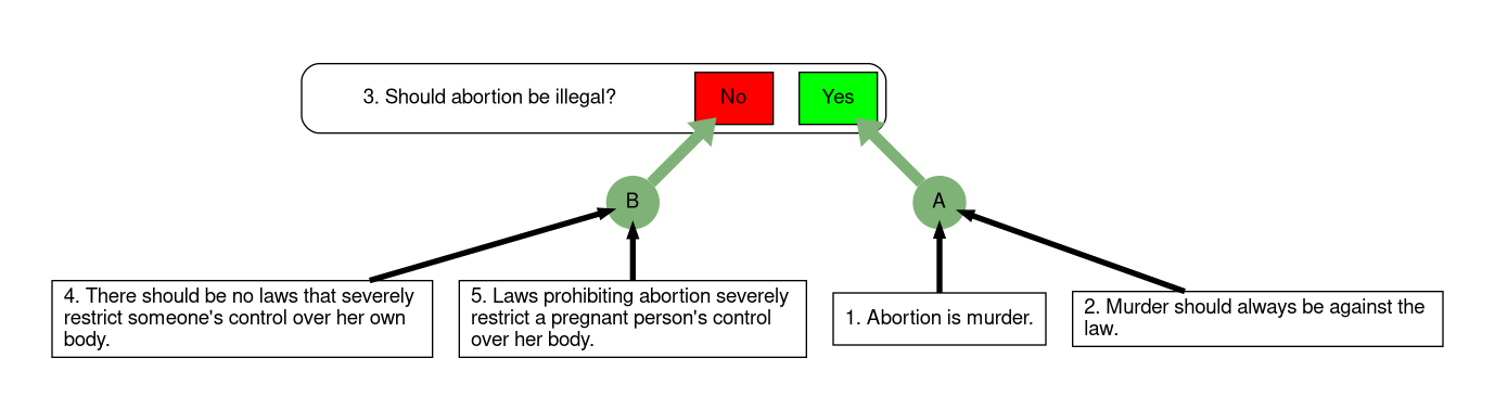

Angela: How can you be opposed to laws banning abortion?!
Ben: Easy, I respect the right to bodily autonomy! Laws against abortion severely limit pregnant women's bodily autonomy.
Angela: But, abortion is murder, and murder should always be illegal.
In this brief exchange, Ben and Angela each give the other a reason for accepting a different answer to the question "Should abortion be illegal?" Each of these reasons is an argument in the sense of that word in which it is used in philosophy (and allied fields). Put roughly: an argument is a reason for believing something, and it is made up of other beliefs. We can represent Ben and Angela's arguments graphically in what is called an argument map:
| Map 1: Ben and Angela's Arguments Concerning Anti-Abortion Laws |
| Ben's argument is labeled "B", and Angela's is labeled "A". |
This article is about arguments (in this sense of the word). We'll discuss what arguments are, their role in thinking, how argument maps can be used to illustrate their structure, and how we can assess arguments to determine how strong they are.

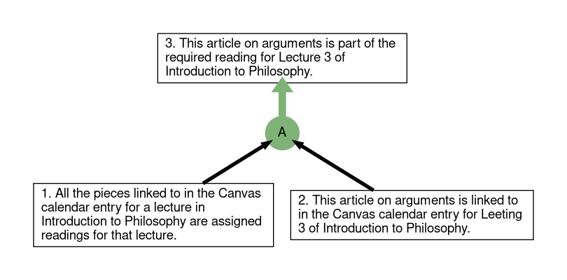

| Map 2: How you know that this article is assigned for Lecture 3 |
This argument isn't about convincing anyone of anything. It is simply how you know something in the first place. You know that this article is assigned for Lecture 3 by knowing two other things: that this article is linked in the calendar entry for the lecture and that everything linked in a calendar entry for a lecture is a required reading for the lecture. When you combine your knowledge of these two facts, they lead to the further knowledge that this article is assigned for the lecture.
On the map, each fact is depicted in a rectangle and labeled with a number. I'll refer to the contents of such boxes as propositions—a term I'll explain below. For now we can say that you in Argument A, you come to know Proposition 3 by combining your knowledge of Propositions 1 and 2. We call Propositions 1 and 2 the premises of Argument A.
Some of you might have come to know that this reading was assigned without knowing these premises—without having looked at or thought about the calendar at all. You may have simply heard me say in class that the reading was assigned. If so, you wouldn't know Proposition 3 by Argument A, but rather by Argument B, which is pictured alongside it the map below:
| Map 3: Two ways in which you can know this article is assigned for Lecture 3 |
Here we see two separate arguments for Proposition 3, labeled A and B. Each argument has two premises, which combine to give you a way of knowing the same fact. Notice, that in each argument the two premises work together to enable you to know the Proposition 3. Knowing that the article is linked to in the calendar entry, wouldn't put you in a position to know that it was assigned reading, if you didn't also know that the items linked in the entries are assigned readings. And, of course, knowing that the items linked in the entries are assigned readings wouldn't put you in a position to know that this article was assigned, if you didn't also know that it was linked. So neither Proposition 1 nor Proposition 2 on its own puts you in a position to know Proposition 3. Argument A's premises only put you in a position to know Proposition 3, when when they're combined.
The same goes for Argument B. Neither Proposition 4 nor Proposition 5 consideredon its own, would put you in a position to know Proposition 3, but combining Propositions 4 and 5 does put you in a position to know it. Notice, also that it's not just any combination of premises that would put you in a position to know Proposition 3. The combination of Propositions 1 and 4 wouldn't do it, and neither would the combination of Propositions 2 and 5. Only two specific combinations of these four premises amount to ways of knowing that Proposition 3 is true. And each of these combinations is a distinct argument for the proposition.

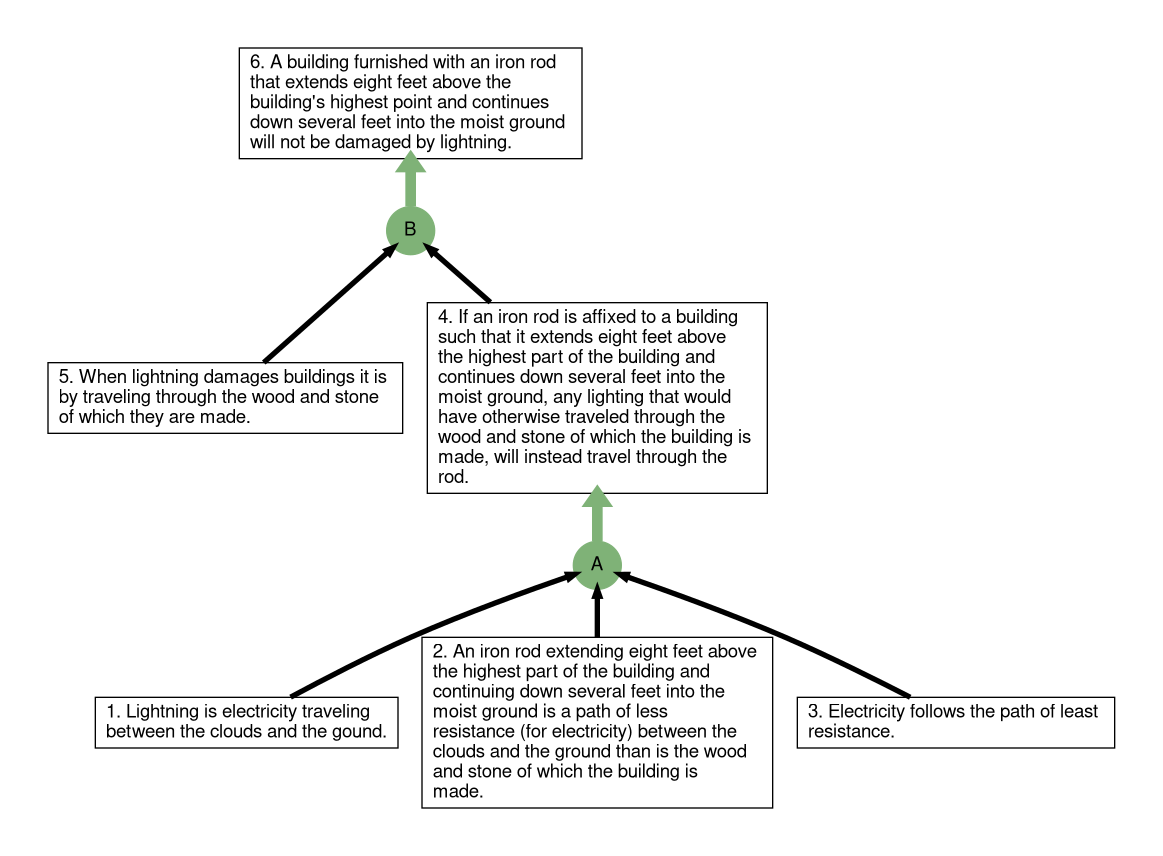

| Map 4: How Benjamin Franklin Knew His Lightning Rod Would Work |
The last few arguments we've discussed are ways in which someone knows something. Of course, if you knew something by means of one of these arguments, you might tell the argument to others in order to convince them of what you know. This may be what Ben and Angela are trying to do in our earlier example, in which they're arguing with one another about laws prohibiting abortion. He tells her how he thinks he knows that there should not be such laws, and she responds by telling him how she thinks that she knows that there should be. Of course, they cannot both be right, so at least one of them must not really know and the relevant argument must not really be a way of knowing. There must be something wrong with at least one of their arguments. For example, one of their premises might be false. But even if one of the arguments is faulty, it is still an attempt at knowing. The point of the argument is to help us tell whether laws prohibiting abortion are wrong or right.
Later in this article we'll discuss how to evaluate arguments, but the first point to bear in mind when evaluating them is that they are attempts to help you to know something—to put you in a position to tell that it is true. Some arguments take us all the way there, but arguments that don't might still prove useful (by bringing us closer to knowledge than we'd otherwise be).

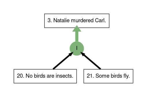

| Map 12 | Map 13 |
Here we have two arguments (H and I) that are both fatuous for opposite reasons. In Argument H we have two awful premises—premises that no one has any reason to believe and that we all know to be false. But inference H is as strong as can be—it's a deduction. Propositions 17 and 18 are false, but if they were true, then Proposition 19 would have to be true also. Nonetheless, the unfounded premises make the argument as a whole fatuous. As it happens the conclusion, like the premises, is obviously false. Notice that if we changed Proposition 18 to say "All insects lay eggs" and Proposition 19 to say "All birds lay eggs," the argument would then have a true conclusion and one true premise, in addition to having an inference that's as strong as can be. Nonetheless, it would still be fatuous, because Proposition 17 remains unfounded (indeed obviously false), and an argument can be no stronger than its weakest part.
Both premises of Argument I are certain, but the argument is fatuous because Inference I is so bad. There's no relation at all between the premises and the conclusion, so even if we know the premises to be true, they can't give us any reason at all to even suspect that the conclusion might be true. You can’t infer anything about Carl and Natalie from premises about birds and insects. Inferences this bad are called non sequiturs.

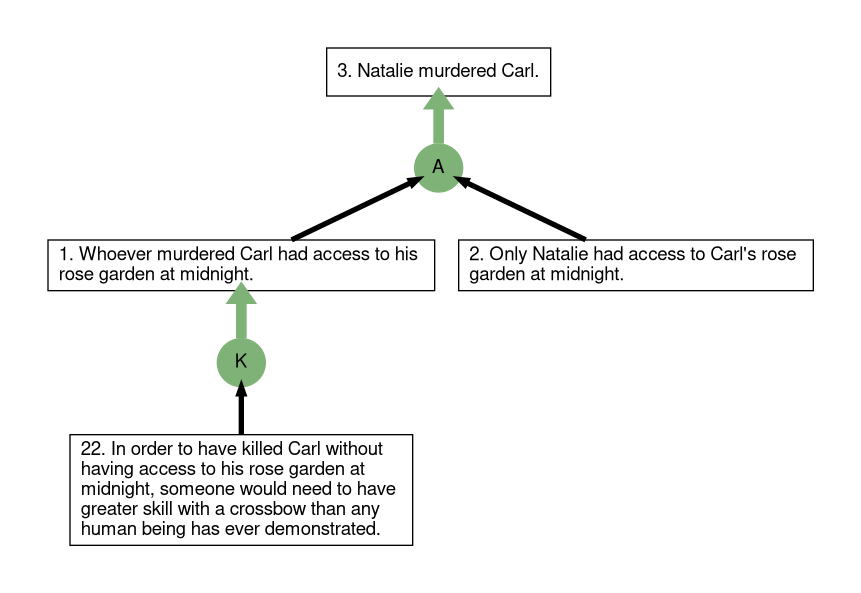

An inference does not need to be a deduction to put one in a position to know its conclusion. Consider the following argument:
| Map 14 |
This is like Argument A from Map 9, except that we've replaced Proposition 1, which said that Carl's murderer had access to his rose garden, with a premise that allows for an extremely remote possibility of someone committing the murder without having had access. Because of this, unlike Inference A, Inference J is not a deduction. But it is still a very strong inference. To judge just how strong it is, we'd have to rely on some background knowledge of the situation. For example, if among Carl's associates were people who were at the cutting edge of crossbow marksmanship, we might regard it as a possibility that the murderer is someone other than Natalie—someone who has an unprecedented level of skill with the weapon. But, in most contexts, such speculation would be unfounded. In this case, Inference J is strong enough that being certain of its premises would put us in a position to be certain of its conclusion. That's how I assessed it on the scale above.
Incidentally, instead of thinking of Proposition 22 as an alternative premise to Proposition 1 in an argument to the same conclusion, we might think of Proposition 22 as part of how we know that Proposition 1 is true, as illustrated in the following map.
| Map 15 |
This amounts to a different way of mapping what is in essence the same line of reasoning.
In any case, whether we focus on Argument K (in this most recent map) or on Argument J (in the map above it), the point remains the same. The inference isn't a deduction, but it's strong enough that being certain of its premises would put us in a position to be certain of its conclusion. We can call such inferences compelling.
