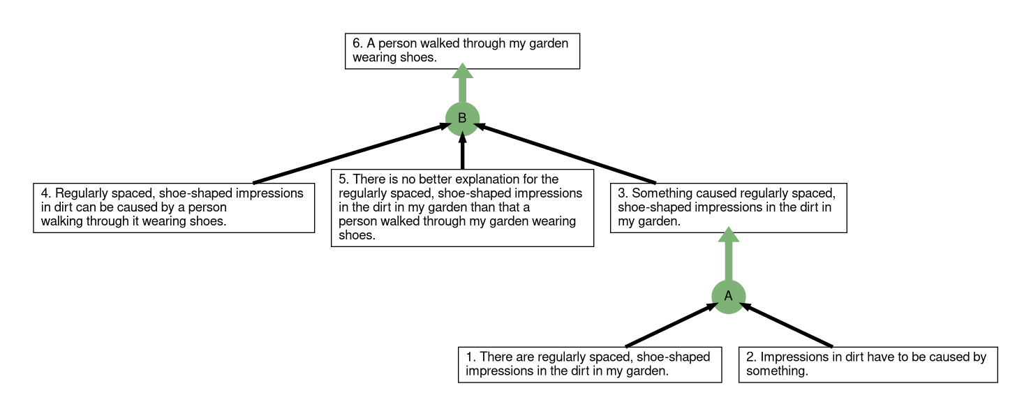

When you look at a patch of ground and see regularly spaced shoe-shaped impressions in the pattern that we call “foot-prints”, you immediately infer that someone walked there. What argument are you using? Perhaps this one:
This is a valid deductive argument, but Proposition 5 is false. There are other things that could cause such a pattern of impressions in dirt. For example, a single large stamp with a footprint-like pattern on it could have been pressed into the dirt, or the pattern could have been made by a robot or specially trained chimpanzee walking upright with shoes on. You can probably come up with some other similarly outlandish ways in which such a pattern in dirt could be created. But even though there are things other than a walking person that could cause impressions of the relevant sort, it is clear that, in most circumstances at least, the best explanation of the footprints would be that someone walked by. Because of this, it is eminently reasonable in almost all circumstances to conclude from seeing such a pattern that a person walked by; indeed, unless one had some special evidence to the contrary, it would be irrational not to draw this conclusion. However, the inference taking place is not a deduction; it is an “inference to the best explanation”. If we wanted to lay out the argument it would be as follows:

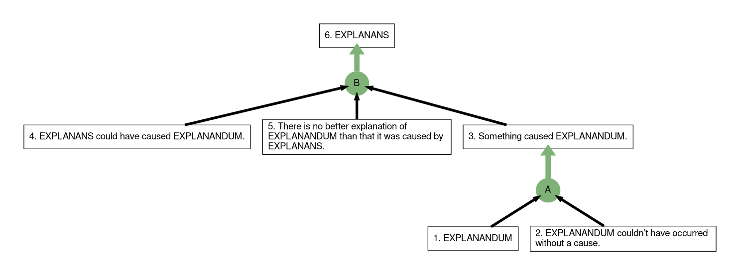

Such an argument depends on knowing (or having excellent reason to believe) several things: (1) that the effect in question exists, (2) that it is an effect (that is, something which is caused by something else), (3) what sorts of things could cause the effect, (4) which of these causes explains the effect best. Notice how these four correspond to the premises in the argument above. We can restate the form of argument involved as follows:
The Latin word “explanandum” means “thing to be explained” and the word “explanans” means “thing that explains.” So if we just replace these (capitalized) words in the map above with the thing we want to explain, and with our theory of what explains it, we’ll get a map of an inference to the best explanation.
If all the premises of such an argument are certain, then the degree of support the argument provides for the conclusion is proportionate to how much better the explanation in question is than whatever alternative explanations may be available. In the example of the footprints, the alternative explanations are all quite poor, so the conclusion is either certain or nearly so. But in a case where there were several decent explanations, the conclusion would only be probable, or merely possible, depending on how good the other explanations were. For example, think of a murder which any of three people could have committed. The murder is the effect, and there are three explanations corresponding to the three suspects—let’s call them Ed, Fran, and George. Suppose that the best of these three explanations is that Fran did it (perhaps she had a stronger motive than either of the others), but that this explanation was only slightly better. If so, then the argument would only make the proposition that Fran committed the murder possible, because though it is more likely that she’s the murderer than it is that Ed is or that George is, it is still more likely that the murderer is one of these two men than that it is Fran. Indeed, Fran is probably innocent. This shows that, to assess an inference to the best explanation we need to know not only that the explanation in question is the best one, we need to know how much better it is than competing alternatives. Also, we should keep in mind that the competing alternatives here aren’t limited to explanations we’ve already come up with; they include others that might not yet have occurred to us.
